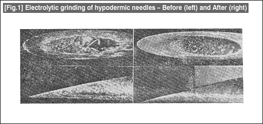

General steel alloys can easily be machined and ground by conventional means and seldom require electrolytic grinding. But electrolytic grinding is a excellent alternative in case of heavy cutting high speed steel alloys where heat damage risks are present, for easily bent and damaged thin plate materials and flat grinding of honeycomb structure material, and for vanadium rich high speed steel alloys that cause heavy wear on grinding wheels. Also, the process does not cause any burrs rendering quite attractive for hypodermic needles and multi-layer materials.

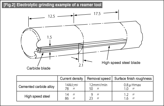

The most applicable example for electrolytic grinding is for carbide cutting tools. Such hard-to-grind high hardness material grinding can gain the most from increased processing speeds.
![[Fig.2] Electrolytic grinding example of a reamer tool [Fig.2] Electrolytic grinding example of a reamer tool](http://www.misumi-techcentral.com/tt/en/surface/images/043_2.gif)
[Fig.2] shows an example of electrolytic grinding of a reamer tool. As can be seen in [Fig.2], the carbide and high speed steel blades, 1.5mm thick/2.1mm wide, are ground in a single path. Usage conditions of a diamond grinding wheel with 60~80 grain size and electrolyte containing NaNO2 and the results are shown in a chart within [Fig.1].
With conventional grinding methods where removal amount is small per one tool path, multiple positioning is needed for multiple tool rotations. But for the electrolytic grinding, cutting depth can be made deep and all the material can be removed with a single path. Tool position corrections can be made less frequent since the diamond wheel wear is only 15% or so of the standard wheels.
