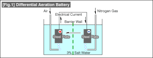

Differential Aeration Corrosion is a type of corrosion phenomenon occurring with oxygen concentration differentials in water where a differential aeration battery environment is formed. As an experiment example shown in [Fig.1], a glass vessel divided with an earthenware barrier wall is filled with 3% salt water, and a pair of polished steel plates with a conductor connected to each are submerged. Using glass tubes, one steel plate is exposed to air and the other steel plate is exposed to nitrogen gas. After some time, the steel plate exposed to the nitrogen gas will corrode. The earthenware barrier wall is to keep the liquid in each compartment separated but to allow for electrical conduction. This corrosion occurs due to a differential aeration battery formation where the air exposed steel plate assumes a reduction reaction of dissolved oxygen as shown below, and the nitrogen exposed steel plate dissolves.

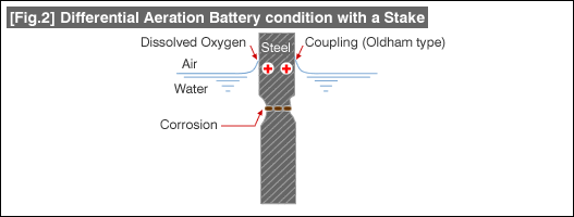

As an example, let us examine a case of corrosion of a stake driven into water. With passing time, a local corrosion just below the water line will be evident.
This is a case of Differential Aeration Corrosion as shown in [Fig.2]. The water around the stake at the water line is slightly raised due to water surface tension. The water layer is thin at this immediate area and receives rich oxygen from the air in comparison to the water below the water line. This creates a differential aeration battery condition.
