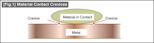

Compounded metal structures contain numerous clearances (crevices) where similar and dissimilar metal members and materials are jointed, as well as under scales and corrosion byproducts and coatings.
The crevices in discussion here are unlike the ones in typical discussions but are very small, in order of 1/100mm scale. Even into these small crevices, water and other liquids will intrude. Once such liquids intrude into these clearances, they would stay there since there would be little exchange with the outside and the oxygen concentrations become low. This oxygen concentration differentials cause formation of differential aeration batteries, and the crevices low in oxygen concentration will corrode. [Fig.1] illustrates an example of crevice formation on a metal plate with a material in contact.
Anodic reaction in crevices, and cathodic reaction on the external surfaces will progress. The metal ions generated by the anodic reaction will become of corrosion byproduct. With crevice corrosion of stainless steel equipment, potential difference between the equipment body and crevices may be as high as 0.2V (200mV) or more.
