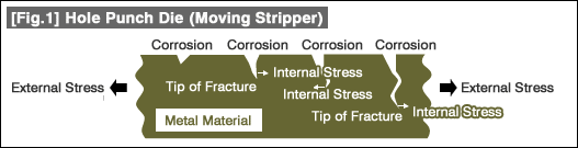

As seen in metal tensile tests, a metal specimen pulled at two ends will eventually result in a fracture. This is called Tensile Strength. In certain environments, metals can fracture at less than rated tensile loads. The phenomenon is called Stress Corrosion Fracture. The stress that cause Stress Corrosion cracking is in tensile, including stresses during the usage and internal stress applied during machining.
[Fig.1] is a schematic illustration of Stress Corrosion cracking. Corrosion points occurring on the surface gradually progress. Either internal or external tensile stress is applied on this material and the corrosion and fracture tips will become sharp, and the direction of the advancing fractures will zigzag. The fractures may be crystal grain boundary type or intra crystal type.
