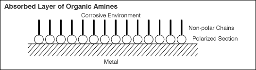

(3) Layer Forming by Steel Surface Absorption
This is a molecular layer forming process by agents being absorbed by the metal surfaces. Typical example pf this is organic amines. The polarized section of the amines containing nitrogen adhere to the steel surface, and other non-polarized sections are oriented outward creating a water repelling structure. When the surface is covered with such absorbed layer, the overall electrical potential will become positive, and frequently used as an inhibitor (anti-dissolve agent) for pickling baths.
