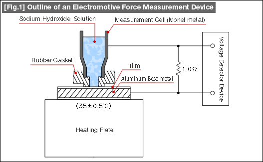

(2) Alkaline corrosion resistance test by Electromotive force
This testing method is also unique to Japan and is an improved variant of the Alkaline Dropping Test, based on a principle of time measured for a predetermined area of a film to dissolve in sodium hydroxide solution.
The test uses an electromotive force measurement device shown in [FIg.1] where the tested specimen kept at 35°C is made to contact 1mL of 100g/L sodium hydroxide solution and measuring the 1mV voltage between the measurement cell and the base metal to investigate the corrosion resistance.
![[Fig.1] Outline of an Electromotive Force Measurement Device [Fig.1] Outline of an Electromotive Force Measurement Device](http://www.misumi-techcentral.com/tt/en/surface/images/100_01.gif)
Compared to the alkaline dropping test, this method is easier to operate, eliminates human induced errors, and since it uses a relatively large amount of test solution of 1mL a film as thick as 20μm or more can be measured.

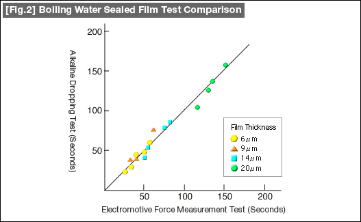

[Fig.2] shows testing results of boiling water sealed sulfate film corrosion resistance compared between alkaline dropping test and electromotive force measurement test. They show virtually identical results.

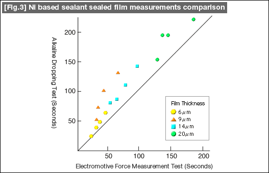

![[Fig.2] Boiling Water Sealed Film Test Comparison [Fig.2] Boiling Water Sealed Film Test Comparison](http://www.misumi-techcentral.com/tt/en/surface/images/100_02.gif)
[Fig.3] shows a comparison of results of an alkaline dropping test and an electromotive force measurement test of a sulfate bath sealed film using a commercially available nickel based sealing agent. The alkaline dropping test yields higher result.
![[Fig.3] Ni based sealant sealed film measurements comparison [Fig.3] Ni based sealant sealed film measurements comparison](http://www.misumi-techcentral.com/tt/en/surface/images/100_03.gif)
As it can be seen, it should be noted that alkaline corrosion resistance measurements are strongly effected by the pore sealing process and electrolytic coloring process.
