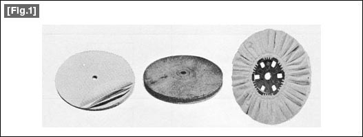

Buff polishing begins with selecting the shape and the material. The buff materials are mainly classified into cotton and hemp linen (sisal), and shapes are classified as follows. (see [Fig.1])
- Paper buff
Circular canvas cloth are stacked and sawn together and polishing material is adhesive fixed. Mainly used for rough polishing. - Loose buff
Circular calico cloth are stacked and only the center is sawn. The centrifugal force of rotating generates elasticity. - Bias buff
Cloth is cut along fold lines and creases are stacked into round shape. The cloth ends do not fray. - Pocket buff
Folds are made deep and circular sawn together. Air pockets promote Heat radiation and good abrasive retention.
[Fig.1] From left: Loose buff, Paper buff, Bias buff
