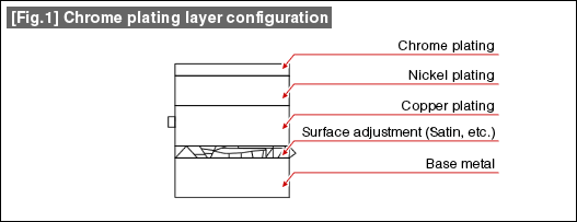

※(Note 2) Composition of ornamental plating film (Chrome plating example)
The external appearance desired for ornamental platings are requested by combinations of 1. , 2., and 3. of the (Note 1). In order to correspond to that, the base metal is mechanically surface adjusted prior to the plating application, and the plating multiple layer configurations are determined based on required colors, glossiness, and corrosion resistance characteristics. In practice, the cost of each plating is important and combinations are determined with these consideration.
