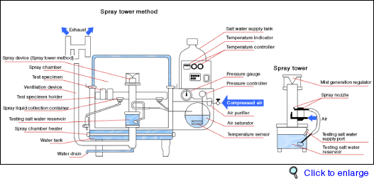

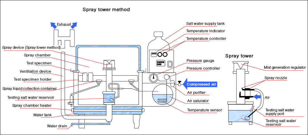

Salt water spray tests are often used to evaluate the corrosion resistance performances of metal materials and inorganic and organic plate coatings applied on metal materials. Neutral salt water spray test methods are explained here.
(1) Test equipment
The system is comprised of Salt water spray device, Specimen holder, temperature controllable spray chamber, Air saturator that saturates the test environment air with water. Required conditions for the test equipment are as follows.
![]() | 1. | The spray equipment is to be of Spray tower or Nozzle type. |
![]() | 2. | The spray chamber is to be 0.2m3 or more. |
![]() | 3. | The chamber ceiling or the cover is designed not to drip the test solution on the specimen. |
![]() | 4. | The equipment is to be corrosion resistant. |
![]() | 5. | The chamber environment is not to be affected by the external air, and the solution dripped from the specimen is not to be re-deposited on the specimen. |
![]() | 6. | The test specimen can be held in prescribed angles. |
![]() | 7. | Two or more spray liquid collectors with horizontal collection area of 80cm2 are to be provided. |
