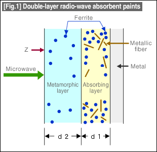

Single-layer radio-wave absorbent paints and double-layer broadband radio-wave absorbent paints are available as the ferrite radio-wave absorbent.Radio waves are absorbed by the single-layer type by coating the metal surface with the resin mixed or dispersed with ferrite powders and carbon black or metal powders.These paints are used for the marine vessels radar.
As shown in [Fig.1], the double-layer radio-wave absorbent paints are comprised of two layers: the metamorphic layer and the absorbing layer that absorbs electromagnetic energy on the metal plate. They are compatible with electromagnetic waves in a broad spectrum. The film thickness of approximately 1.3 mm can deliver sufficient performance by using the composition of epoxy, ferrite, and brass fiber for the absorbing layer. A metamorphic layer uses silicate non-organic pigments besides the ferrite in order to improve performance, including the mechanical property and the permeation preventing capacity of the paint film. Modifying the mixture ratio of these can change the broadband absorption characteristics. |
