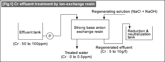

(2) Ion-exchange method
This method adsorbs and removes anion (= chromic acid) using anion exchange resin. [Fig.1] is an example of the flow diagram.
The ion exchange resin used to adsorb chromic acid will eventually become saturated and no longer able to adsorb more ions. It is important to replace the resin before hexavalent chromium starts leaking.
The saturated ion-exchange resin will be collected by a chromic acid manufacturer, who regenerates the resin and recycles the eluted chromic acid. The regenerated ion-exchange resin is returned to the surface treatment plant.
