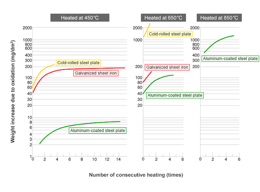

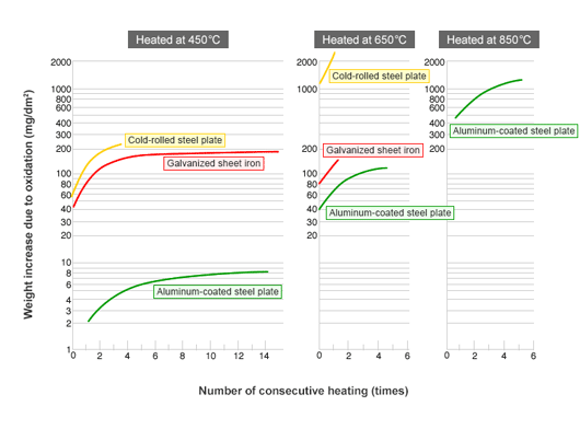

(3) Heat resistance
[Fig.] shows the increasing amount of oxidization measured at certain temperatures after heating the various types of steel plates.
Up to the relatively low temperature of around 500°C, the dense alumina layer formed by oxidation occurred on an aluminum surface layer inhibits the diffusive intrusion of oxygen. For temperature higher than this, the Fe-Al alloy exerts the superior resistance to oxidation when the aluminum diffuses into the steel substrate.
