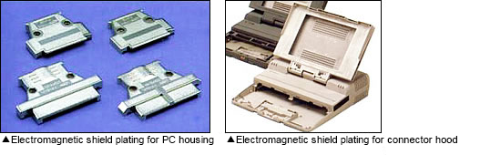

In today's IT era, electroless copper/nickel plating is applied on polycarbonate computer housings, keyboards, connector hoods and more, in order to protect these devices from electromagnetic waves.
