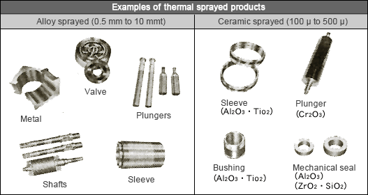

Self-fluxing alloy sprayingNi-B-Si, Ni-Cr-B-Si, Co-Ni-Cr-B-Si, and so on
Ceramic sprayingAL2O3, AL2O3-TiO2, TiO2, ZrO2, ZrO2-Y2O3, and so on
Cermet sprayingOxides, carbides, nitrides, borides, silicides, and medals
Plastic sprayingNylon, epoxy, etc.
Thermal spraying is also classified by the following purposes of application: spraying for prevention of corrosion, rust and abrasion, heat-resistant spraying, thermal barrier spraying, build up spraying, spray forming, and so on.
