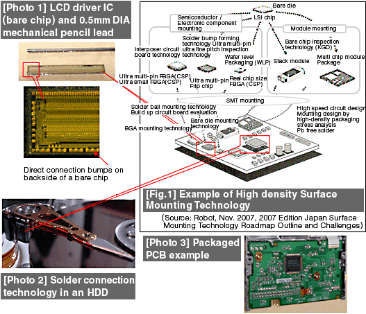

(1) What is Surface Mounting Technology?
It can be said that miniaturization technology for the functional components including LSIs is the key technology to realize performance/functionality improvements and miniaturization for portability (high density) of electronic information devices and systems. The interface technology to interconnect these devices reliably and compactly is called [Surface Mounting Technology (High Density Surface Mounting Technology)]. ([Fig.1])
![[Fig.1] Example of High density Surface Mounting Technology,【[Photo 1] LCD driver IC (bare chip) and 0.5mm DIA mechanical pencil lead,[Photo 2] Solder connection technology in an HDD,[Photo 3] Packaged PCB example [Fig.1] Example of High density Surface Mounting Technology,【[Photo 1] LCD driver IC (bare chip) and 0.5mm DIA mechanical pencil lead,[Photo 2] Solder connection technology in an HDD,[Photo 3] Packaged PCB example](http://www.misumi-techcentral.com/tt/en/lca/images/149_01.gif)

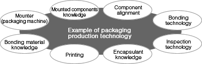

(3)Items required for the mechanical designers in surface mounting production technology
From the examples above, the engineers who design the surface mounting equipment are required to have the ability to understand a wide variety of related production technologies as follows.
