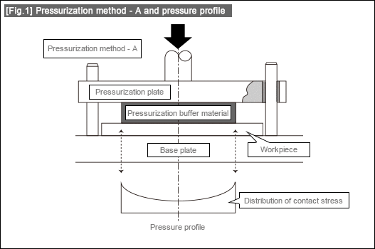

1)Pressurization method - A
・Pressurization method - A is used in the case where pressure is applied to the area inside the circumference of the workpiece to pressurize the inner side of the workpiece using pressurization buffer material.
・The figure below illustrates the pressure profile in this case.The contact stress peaks at the circumference edge of the pressurization buffer material, and it begins to fall toward the center of the workpiece.
・Use of the pressurization buffer material will give some allowance for the parallel precision required for the opposing surfaces of the pressurization plate and the base plate, and rigidity of the whole mechanism.

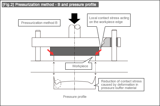

2)Pressurization method - B
・Pressurization method - B is used in the case where pressure is applied to the whole area of the workpiece when the pressurization buffer material is larger than the workpiece (Fig. 2).

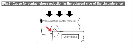

・In this case, the contact stress to pressure buffer material acts intensively upon the circumference edge area of the workpiece in the directions indicated by the red arrows.This intensive contact stress onto the edge area causes local deformation of the pressurization buffer material inside the edge area, which results in a sudden reduction of contact stress in the adjacent side of the circumference (Fig. 3).

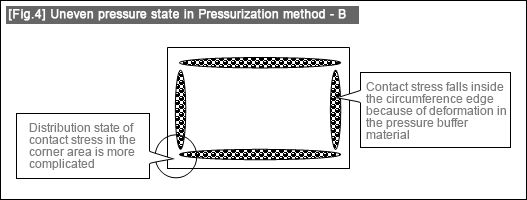

・This reduction of contact stress in the adjacent side of the circumference will cause unevenness of bonding or uniformity in a fine gap between two panes of glass substrates, which affects product quality (Fig. 4).
・Selecting appropriate property of elasticity such as hardness of pressurization buffer material can restrain reduction of contact stress in the adjacent side of the circumference to a certain extent, but there are no fundamental countermeasures effective for the issue.
・In both pressurization methods A and B, distribution states of contact stress are more complex and the precision tends to deteriorates on the corners of the workpiece.
