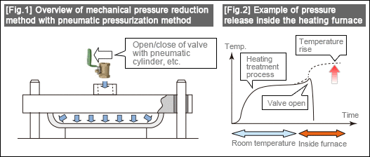

1)Countermeasure for pneumatic pressure fluctuations by heating
・When a pneumatic pressurization method much like rubber expansion body is used with heating treatment, the energy inside the heating furnace will be greater than the pneumatic pressure in the room temperature, since the pneumatic pressure rises because of the heating temperature.The pressure conditions, thus, must be selected in consideration of this effect.
・If pressure rise due to heating cannot be addressed just by changing the pressure conditions, use of a pressure switch (mechanical or electrical), which reduces pneumatic pressure during heating process, might be one solution for the situation.
・When a heating furnace is used, it is simple to adopt a mechanical pressure release handle (for example, ball valve, Misumi BRKT) and to reduce the pressure by mechanically opening an open valve with a pneumatic cylinder, etc. (Figs.1 and 2).

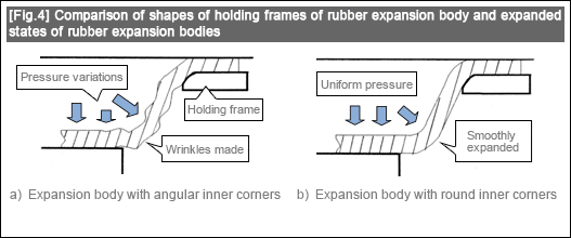

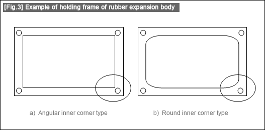

・Fig.3-a shows a commonly-used angular holding frame, whereas Fig.3-b shows a holding frame with large round inner corners.
・Fig.4 shows the states of circle parts of those rubber expansion bodies in Fig.3. The rubber expansion bodies are fixed to the individual holding frames and expanded.
・In Fig.4-a, the corners of the rubber expansion body are deformed in a complex manner.In Fig.4-b, the rubber expansion body is expanded with smooth curved surface.
・It is required to select the proper shape of holding frame as shown in Fig.4-b and the optimal volume of expansion of the rubber expansion body, and also to adopt a fixing mechanism free from air leaks during expansion even after use for long hours.
