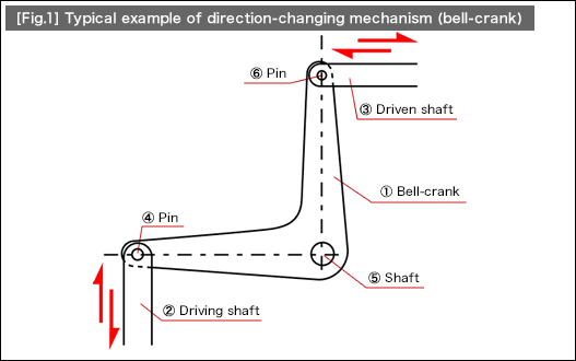

[Fig.1] is an example of the direction of motion changing between two links on the same plane of a 90-degree bell-crank.
The bell-crank shown here is a component consisting of two links connected at a certain angle on the same plane. In [Fig.1], the vertical reciprocating motion of the driving shaft (2) is transformed into the horizontal reciprocating motion of the driven shaft (3).

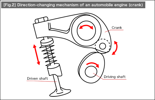

[Fig.2] illustrates the direction-changing mechanism (crank) adopted for automobile engine parts.

In the case of [Fig.1], forces from the driving shaft will be transmitted through the pin (4) to the bell-crank. The forces rotate around the shaft (5) and travel to the driven shaft (3) through the pin (6). When designing this structure, the following two points must be kept in mind:
| a) | Select appropriate fit dimensions for pin diameter/hole and shaft diameter/hole for smooth movement | |
| b) | Adopt abrasion-resistance measures |
