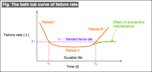

III.Wear-out failure period (wear-out failure)
This is the period in which failures occur during continuous production using molds, etc., due to their being used near the expected life in terms of the number of shots.
The cause of such failures is the wearing out of components. The period when wear-out reaches the limit of usability can be predicted using sampling and by experience.
Therefore, it can be said that it is possible to some extent to avoid the occurrence of wear-out failures by preventive maintenance.
The relationship between the failure period and the failure rate plotted as a curve as shown in the figure is called the bath tub curve because the curve of failure rate with respect to the time axis is similar to the cross-sectional shape of a bath tub.
