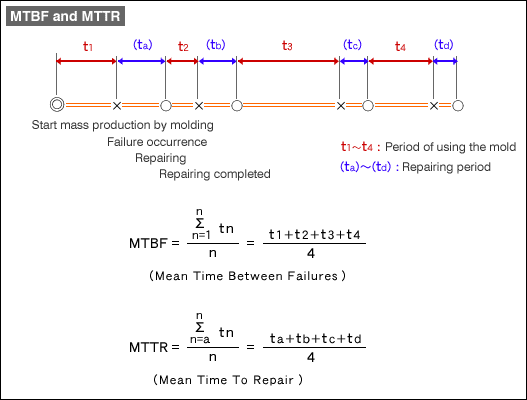

The average time after a mold has failed until the next failure occurs is called the MTBF. Therefore, the unit of MTBF used is time (hr, min, etc.) or the number of shots.
When the value of MTBF is large, it can be evaluated that the mold is one in which failure is difficult to occur.
On the other hand, if the value of MTBF is small, it can be said that the mold is likely to fail easily, and it is difficult to make a plan of production of stable molding operations.

On the other hand, as an index for evaluating the ease of repair of molds, there is what is called the Mean Time To Repair (MTTR).
In case a mold fails, the MTTR of that mold has a small value if it is possible to repair it quickly.
As an example, if spare parts are always in stock, and also if the structure is such that it is possible to replace the spare parts from the parting surface even without removing the mold plate of the cavity, then the MTTR will become a small value.
MTTR, also, has a lot of importance as an index for evaluating the maintenance and management cost.
