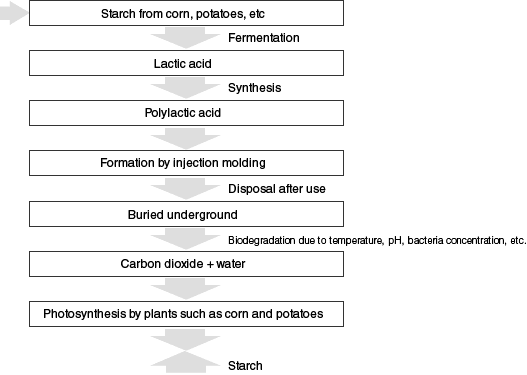

One of the typical biodegradable plastics is polylactic acid (PLA). Polylactic acid is a plant-derived biodegradable plastic resin. It is chemically synthesized using the following synthesizing process, and is recycled using the biodegradation effect.
Polylactic acid is relatively hard and has about the same mechanical strength as polystyrene. Although it is being used in industrial applications for about ten years, since the strength and heat resistance are insufficient, it has not been used much in industrial products of high added value.
