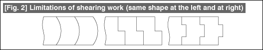

There are limitations such as those shown in Fig. 2 in carrying out the work along a single line. In other words, the shapes should be the same at the left and at the right. Some times it is possible to carry out shearing work by slightly changing the product shape therefore it is desirable to use shearing work.
