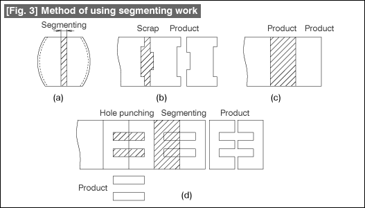

Figure 3 shows a method of using the segmenting work. Fig. 3(a) shows a method of use in which the segmenting work is very clear. Two left and right symmetrical products or two products are produced because of the balance of the working force in bending or flange formation work or when the production quantity is large. Thereafter the segmentation work is made. Fig. 3(b) is the case when blanks are taken from a sheet material or a coil material. Scrap equal to the punch width will be produced. Fig. 3(c) is a modified application of (b). If the shape is as shown in the figure, and if the die dimensions are determined so that even the scrap becomes a product, it is possible to carry out the work without generating any scrap, and even the production efficiency becomes better. Fig. 3(d) is still another modified application. This form is very famous as the method for producing EI cores. In this case, the product has been designed considering the rate of material utilization and the production efficiency. This can be said to be an extremely superior working method that has cleverly matched the features of the product shape and the features of the working method. This can be said to be an example of the result of cooperation between pressing work and product design.
