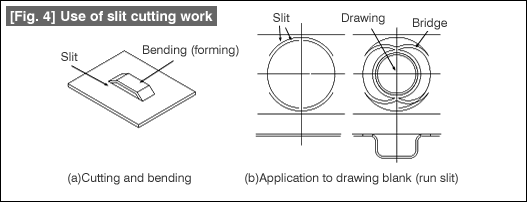

Figure 4(a) shows a method in which slitting and forming are done at the same time. The height of forming is prepared by the elongation of the material. Although both sides are cut in the figure, it is also possible to carry out formation in which only one surface is cut. This type of formation is called louver formation. Louver cutting is used very frequently for vent holes. Fig. 4(b) shows a form in which the slit cutting operation can be used for drawing. By making two slits, the fluctuation of the material due to shrinkage of the blank during drawing work is absorbed.
