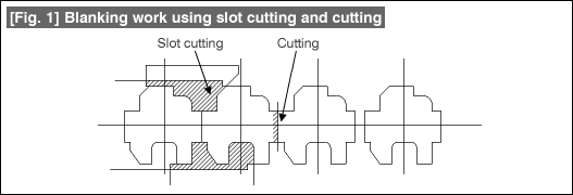

Figure 1 shows an example for forming an outer contour shape using slot cutting and cutting. Slot cutting forms the shape along the width direction of the material and the shape along the feeding direction is formed by cutting, thereby saving material. Since cutting operations are used, the direction of the burrs in the product will be different in some parts when compared with other parts.

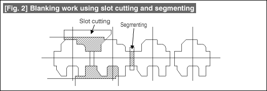

Figure 2 shows an example for forming an outer contour shape using slot cutting and segmenting. In this form, the direction of the burrs is the same along the entire periphery of the product. This method can be said to be the most frequently used one among all the methods of forming shapes by outer cutting.

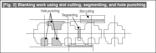

In this method for forming a shape, one blank and the next blank are connected near the center of the material. Depending on the product, guiding along the width direction may become difficult. As a countermeasure for this, the forming method shown in Fig. 3 can be used. This is a method in which the original material width is made to remain the same by as much as possible. In order to do this, hole punching operations will become necessary in addition to slot cutting work. By using hole punching work, it is possible to form the shape while maintaining the original width of the material. The advantage of this type of method for forming an outer contour shape is that, not only the material can be guided easily, but also it is possible to prevent the reduction in the strength of the material. The drawback is that the loss of material becomes somewhat larger. This is an example of forming the outer shape using slot cutting and segmenting. In this form, the direction of the burrs is the same along the entire periphery of the product. This method can be said to be the most frequently used one among all the methods of forming shapes by outer cutting.
