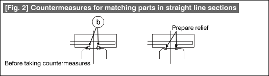

Unless countermeasures are taken for the straight line section matching part of Fig. 2, it will lead to generation of steps or burrs. This is because the same part is cut twice by a punch. The action to be taken is to provide a relief at the part which is cut twice, thereby making the cut parts intersect each other. In the external appearance of the formed product, the matching parts will remain as depressions. Since the matching parts have some effect in this manner in the external appearance, care should be taken so that matching parts are not created in parts where they can affect the functions of the product.

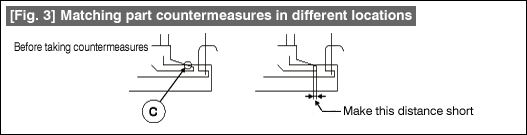

In the matching parts in angular sections shown in Fig. 3, it is easy for plucking type of burrs to be generated. Design a cutting edge shape (cut punch) in which the extension part of the inclined line is as short as possible.
