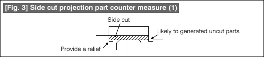

As a countermeasure, the shape of the side cut is made complex thereby solving the problems of projection shaped matching parts and rising of chaff. Fig. 3 is a shape that anybody will try at first. Although it appears as if the problems will get solved, this is not a sufficient countermeasure. Of course, this can also cause the generation of abnormality in the matching parts.
