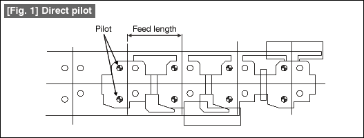

In outer cutting work, the cutting is done by moving (feeding) the material by the feed length (the feed pitch) using the side cut or a feeding device. At this time, any fluctuations in the feed pitch will have effect on the product. "Pilot" is used for the purpose of correcting the feed error immediately before carrying out the cutting.
A pilot is basically a round hole, and the error is corrected by inserting a shaft with a pointed tip (a pilot punch) inside this hole. There are two methods of using the hole. The method shown in Fig. 1 is one in which a hole in the product is directly used for correction, and this method is called a direct pilot. Since a hole in the product is used, the shape will be one without any wastage. The drawback of this method is that the hole used for the pilot may get deformed. Care should be taken about this when the material is a soft material such as copper or pure aluminum, etc.

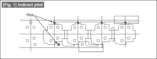

In order to avoid this problem, the form shown in Fig. 2 is one in which a special hole for the pilot is formed in the part that becomes scrap. This is called an indirect pilot. It is possible to determine freely the position and size of the pilot hole. A pilot punch is always inserted into the hole for the pilot immediately after the hole has been punched. If possible, if the pilot is inserted several times in succession, it is possible to reduce the load on each punch. There is a relationship between the diameter of the pilot hole and the diameter of the pilot punch. Although the positioning can be done most accurately when the pilot hole diameter is equal to the pilot punch diameter, the material will be picked up when the pilot punch is coming out of the hole.
