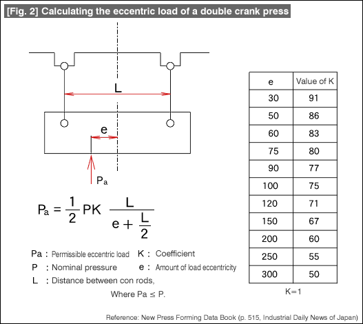

In the case of a double crank press machine (two points), the effect will be smaller compared to a single crank press machine. In the case of formation of products demanding accuracy, one of the reasons why the use of a double crank press machine is better than the use of a single crank press machine is the relationship with this eccentric load. The method of obtaining the permissible eccentric load of a double crank press machine is shown in Fig. 2.
