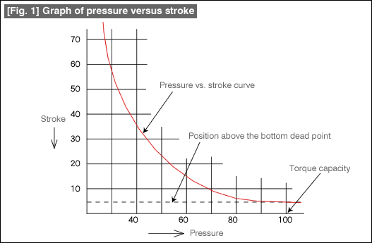

In machine presses such as crank presses, etc., the pressure generated changes depending on the position of the stroke. This point is a big difference from fluid presses such as hydraulic presses in which the pressing force does not change at any position of the stroke. Fig. 1 shows a graph of pressure versus stroke of a crank press.
This indicates that the pressure generated becomes higher as the stroke position of the slide gets closer to the bottom dead point. Theoretically, it is possible to get infinite pressure. In the indication of the capacity of a press machine, the position of the bottom dead point is determined, and the capacity is indicated. This is called "Torque Capacity".
