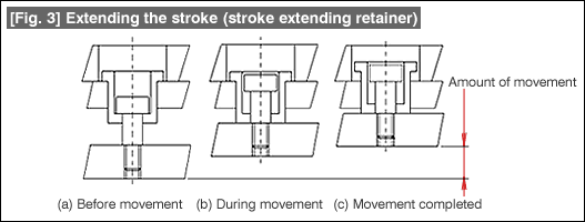

(3) Special method of use
Depending on the die, sometimes there is no space at the top and at the bottom, but a need for making the amount of stripper movement large. In such situations, the usual method of using stripper bolts is not good. Fig. 3 shows an example of obtaining a long stroke in a narrow space by using in combination with a stroke extending retainer.
