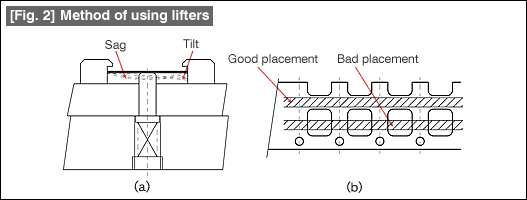

In the dies for successive feeding, very often it is necessary to make the material in the die float above the surface of the die.  This is for feeding the material.  This is also commonly true for transfer dies, dies for robot machining.  Lifters are placed in a balanced manner so that the material does not sag or get tilted as shown in Fig. 2(a).  The precaution in the placement of lifters in a mold for successive feeding is shown in Fig. 2(b).  The lifters are placed and fixed so that they do not interfere with the material during its feeding (the part showing good placement).

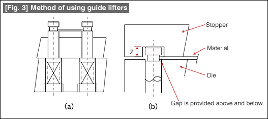

As is shown in Fig. 3(a), guide lifters are components that carry out the functions of both a material guide along the width direction and a lifter.  The basic principle is to place them so that there is no sag in the material.
Fig. 3(b) shows the relationship in the up and down directions.  When the material is on the die surface, guide gaps of the guide lifter are provided above and below the material as is shown in the figure.  If care is not taken about this, the guide lifter can cause crescent shaped scratches or deformations in the material.  Sometimes, the material may also be cut in the shape of a crescent moon.
The pressing down of the guide lifter is made at the head part of the lifter.  Measures should be taken so that there are no fluctuations in the depth Z machined in the stopper.  Take care so that the pushing direction is not tilted because this can cause breakage of the head of the guide lifter.
