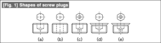

There are five types of screw plugs used in dies as shown in Fig. 1. A screw plug is operated using a hexagonal bar spanner (referred to simply as 'spanner' in the following).
The basic shape is the one shown in (a) in which the spanner hole is not penetrating. The shape (b) has a penetrating spanner hole. The shape (c) is the basic shape with a penetrating round hole provided at the end of the spanner hole.
The shapes (d) and (e) are with a flange, and the two are different in the type of spanner hole.

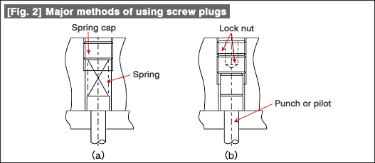

The method of using a screw plug is shown in Fig. 2.
The method of use as a cap screw of a spring is shown in (a). This is the method of use when it is desired to adjust the strength of the spring by the extent of tightening the screw plug.
Care should be taken while using this method to make sure that the spring is compressed at all times. If the spring is not compressed, it shakes inside the hole, and consequently there is the danger that the screw plug becomes loose.

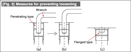

The method of use as a lock nut is shown in (b). A lock nut is a method of using the opposing forces of two screws to prevent the screws from becoming loose. The method of use is shown Fig. 3(a) and (b). An ordinary screw plug and one with a penetrating spanner hole are combined together.
To lock a lock nut, first the spanner is inserted and operated as shown in Fig. 3(a) until the nuts are tightened. After that, the spanner is lifted up as shown in Fig. 3(b) and only the screw plug with a penetrating spanner hole is tightened thereby preventing them from becoming loose. The screw plug with a penetrating spanner hole was developed for use as a lock nut.
Another method of preventing loosening is the flanged type screw plug. Elastic deformation occurs when the flange surface is strongly pressed against the hole. This is a type of screw plug in which loosening is prevented using this force.
