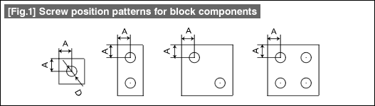

(1) Clamping screws of block components (nested, punch, etc.)
There are a large number of methods of using clamping screws in the case of block components as shown in Fig. 1.
Taking the minimum value of the dimension A in the figure as the screw diameter (D), the thickest screw that can be used is selected from the size of the block (screw breaking countermeasure).
When there are large and small blocks present simultaneously in a die, if the screw size is determined individually for each block, there will be a mix of thick and thin screws, which makes it inconvenient during assembly and disassembly of the die, and hence it is recommended to use screws of the same size.

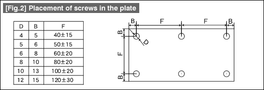

(2) Clamping screws of plate components

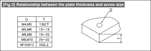

In the case of plate components, as is shown in Fig. 2, the screw size is determined considering the combination of the relationships among the dimension B from the edge of the plate, the pitch F of the screws, and the plate thickness shown in Fig. 3. It is easier to understand if attention is paid to the dimension W of the plate, the dimension B is made about twice the smallest value, and the decision is made considering the relationship between the dimension F and the plate thickness.

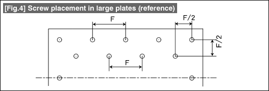

When the plate becomes big, it becomes insufficient to place the screws only near the periphery. In such situations, determine the placement of screws inside the plate such as in the example shown in Fig. 4.
