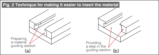

In the state of Fig. 1, it is very difficult for the material to enter the guide. As a countermeasure for this, a material guiding section is provided at the entrance to the guide as shown in Fig. 2.
The form shown in Fig. 2(a) is an extremely obvious shape of an escape. Although there is no problem when the material width and plate thickness are of an easy-to-handle size, if the material becomes wider or the plate becomes thicker, which is a state referred to commonly that the material is oversized, working becomes difficult with the shape of (a). If a step is provided in the guide as shown in Fig. 2(b), it is possible to place the material first on the bottom plate of the guide and then to insert it in the width of the guide, and hence the work becomes easier.
