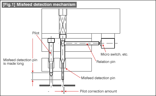

The relationship between the misfeed detection unit and the pilot is shown in Fig. 1.
The misfeed detection is made to operate in the state in which the pilot cannot correct the position of the fed material. Therefore, since it is made to act earlier than the pilot, it has to be made longer and thinner than the pilot (within the correction amount of the pilot). The general form of a misfeed detection unit is constituted from a misfeed detection pin, a relation pin, and a micro switch, etc.

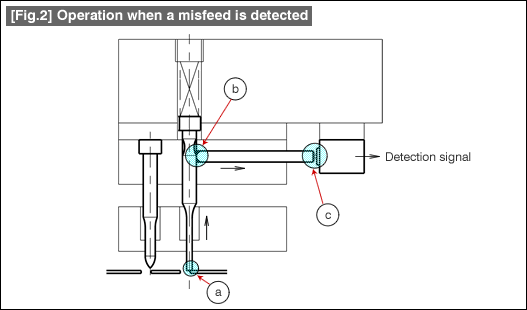

Fig. 2 shows the state in which a misfeed has been detected.
The operation is made in the following sequence
| (a) ↓ | The misfeed detection pin climbs over the edge of the pilot hole of the shifted material. | |
| (b) ↓ | The misfeed detection pin is pushed up. | |
| (c) | The relation pin set in the groove of the misfeed detection pin is pushed sideways and presses a micro switch, etc., outputs the detection signal, which stops the press machine. |

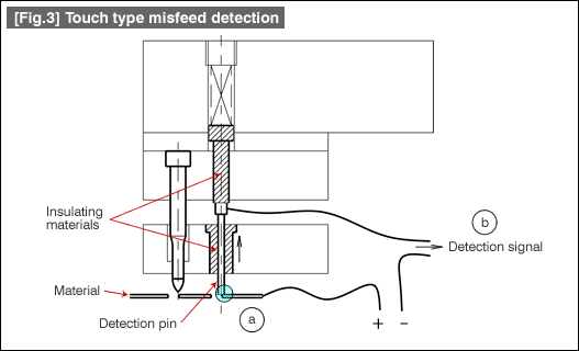

The mechanism in Fig. 3 has been made to operate electrically considering the problem of delay in the mechanical operations.
The example shown in the figure is merely one of the possible examples, and a form with many modifications is used. The principle of operation is that the detection pin is maintained in the insulated state, and a small current is passed between the material and the detection pin. Under normal conditions, no current flows because the detection pin enters the pilot hole without touching the material. If the pilot hole gets shifted as shown in Fig. 3(a) and contacts the detection pin, a current flows, and a detection signal is output stopping the press machine. Faster operation can be obtained compared to Fig. 1. The drawback is that the electrical lead wire of the detection pin is moving all the time during press operation. As a consequence of this, the lead wire is likely to get cut somewhere. If this happens, even if the detection pin detects an abnormality, the press machine cannot be stopped. Periodical checks cannot be avoided.
