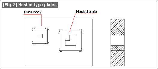

(6) Nested plates (see Fig. 2)
The descriptions given above assume single type plates. In dies, nested type (insert type) plates are used very often. Such plates are used for stripper plates or die plates. In the case of small volume production, materials such as S50C without heat treatment are sometimes used for the main plate. For medium or higher volume production, materials such as SKS3 or SKD11 are used after heat treatment.
The materials SKD11, SKH51, pre-hardened steel, and cemented carbide, etc. are used as the materials for nested plates. The selection of the material is based on ease of maintenance, accuracy, and operating life.
