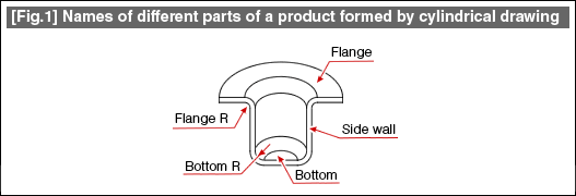

Sometimes it is difficult to refer by names to detailed parts when investigating a product of drawing. The names of some parts that are convenient if remembered are given below.
[Fig. 1] shows the names related to the shape of a product formed by cylindrical drawing.
| (1) | Flange: The part of the blank that is remaining on the surface of the die after blank has been drawn. The edges of the flange will become thicker than the original plate thickness. |
| (2) | Flange R: This is the rounding (chamfer) provided between the flange and the side wall. This corresponds to the die shoulder radius (die R) of the drawing die. |
| (3) | Side wall: This is the part that has risen with respect to the flange when the blank is pushed inside the die by the punch. |
| (4) | Bottom R: This is the rounding of the part corresponding to the punch shoulder radius (punch R). This name has come to be used because this is the rounding of the bottom of the drawn container. |
| (5) | Bottom: This is the surface constituting the bottom of the container. Instead of being called the bottom, it is sometimes referred to as the roof, but recently the name bottom seems to be used more frequently. |
