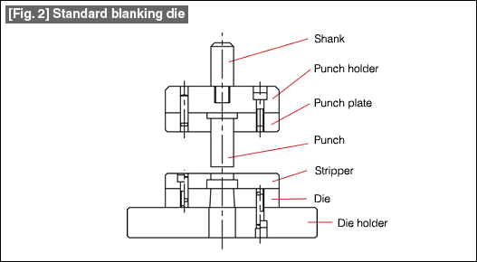

Fig. 2 shows the structure of a standard blanking die. This is a die of the fixed stripper structure. The blanking die is divided into a top die (which is constructed from a shank, a punch holder, a punch plate, and a punch) and a bottom die (which is constructed from a stripper, a die, and a die holder).

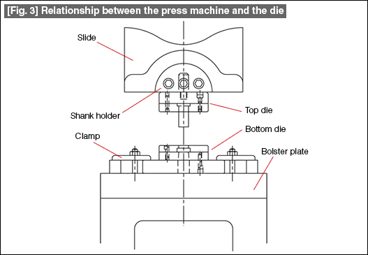

As shown in Fig. 3, the top die is installed to the slide of the press machine. In this example, the shank of the die is installed by fixing it using a shank holder. This is a method of installing the top die in the case of relatively small dies.
The bottom die is fixed using clamps on the bolster plate of the press machine.

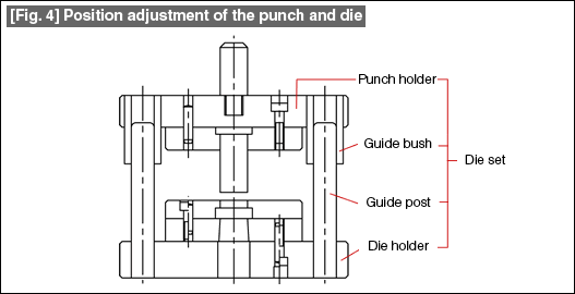

In order to solve this problem, a guide post and a guide bush are used as shown in Fig. 4 so that the relationship between the top die and the bottom die is maintained in the dies themselves. A large number of dies of this type are being used in which the relationship between the top die and the bottom die are maintained constant.
A unit in which the punch holder, guide bush, guide post, and the die holder are integrated into one single unit is called a "die set".
Further, a die of this shape is called a "die with a die set".
