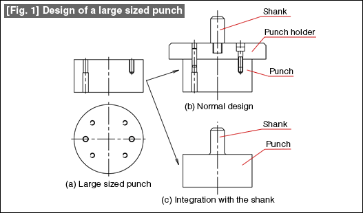

(1) Design of a large sized punch (See Fig. 1)
![[Fig. 1] Design of a large sized punch](http://www.misumi-techcentral.com/tt/en/press/images/129_01.gif)
Since the punch area is large in the case of a large sized punch, it is possible to drill threaded holes for fixing the punch and holes for dowel pins (knock pins) inside that area.
This is shown schematically in Fig. 1 (a). This type of shape can be machined easily using a wire cut discharge machine.
Fig. 1 (b) is a standard shape of an assembly of the top die. The punch plate is omitted and the punch is directly installed to the punch holder thereby simplifying the structure.
In the case of simple shapes such as a circle, etc., it is possible to prepare in further simplified manner by integrating the shank and the punch as shown in Fig. 1 (c). However, as explained in Lesson No. 168, the problem of adjusting the clearances of the punch and the die remains.

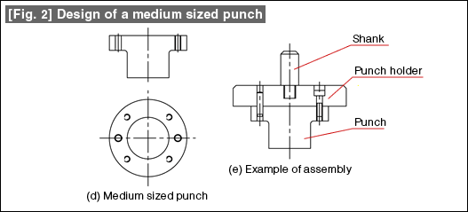

(2) Design of a medium sized punch (See Fig. 2)
![[Fig. 2] Design of a medium sized punch](http://www.misumi-techcentral.com/tt/en/press/images/129_02.gif)
This is a type of punch whose size makes it difficult to drill threaded holes or knock holes inside it.
In the case of a simple shape such as a circle, etc., it is possible to provide a flange and to drill threaded holes or knock holes in the flange part, and to design again a structure in which the punch plate is omitted.
When the shape is complex, a flange is provided at a simple part, and the design is made in a similar fashion.
When this has been determined to be difficult to do, the punch will have to be fixed using a punch plate. Understand that the punch plate is not an indispensable part.

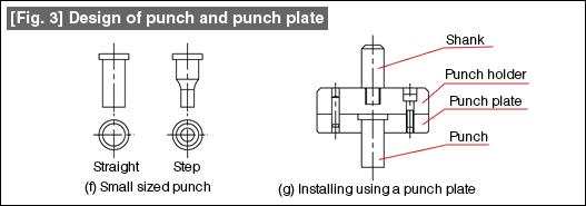

(3) Design of a small sized punch (See Fig. 3)
![[Fig. 3] Design of punch and punch plate](http://www.misumi-techcentral.com/tt/en/press/images/129_03.gif)
When the product becomes small, even the punch becomes small. In that case, it becomes difficult to fix only the punch to the top die, and the method is used of fixing the punch after embedding it in a plate. This plate for fixing the punch is called a punch plate.
As shown in figure (f), the punch is made as straight as possible. When there is some problem in the strength due to the relationship between the size of the punch and the punch length, the design is made to provide a step in the punch.
The relationship between the punch and the punch plate is designed so that the punch is lightly press fitted inside the hole in the punch plate (so that it can enter the hole with light hit with a plastic hammer).
This ensures the verticality and position of the punch.
Since it is difficult to ensure the verticality of the punch when it is fixed by swaging, this method should be avoided as far as possible.
It is standard practice to use S50C or SS400 as the material for the punch plate. The thickness should be about 30% to 40% of the punch length.
