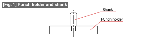

The relationship between the shank and the punch holder is shown in Fig. 1. The punch holder is the part being the base, and the shank is installed above it.
A shank is a part with the shape of a pillar, and is used for installing the top die of a relatively small die in the slide of the press machine. The standard diameters of the shank are 25, 32, 38, and 50 mm. These sizes are a legacy from the sizes in inches. Care should be taken because there are some old machines in which the size is not 25 mm but 25.4 mm. The lengths used are about 50 to 65 mm.
The materials used for shanks are SS400, S50C or equivalent, or FC250.
