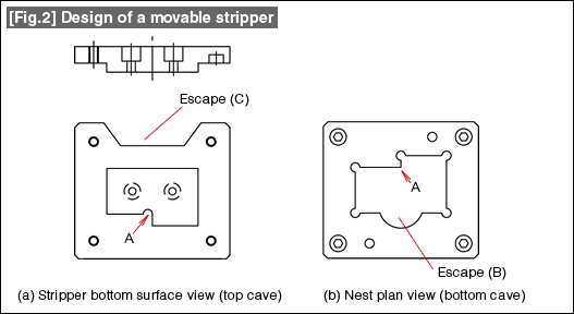

See Fig. 2. When the positioning of the blank is done by a plate nest, it is necessary to scrape the stripper surface into a convex shape to match with the shape of the nest. Very often an end mill is used for machining this shape. The convex shape of the stripper and the shape of the nest are designed so that this machining becomes easy. The peripheral part called the flange of the convex shape becomes thin due to the machining of the convex part of the stripper. If this becomes too thin, it will affect the strength of the stripper. Determine the thickness considering the balance. The part shown as the escape in (C) of Fig. 2 is a part that comes before the die. Safety and security during work is obtained by providing this escape.
