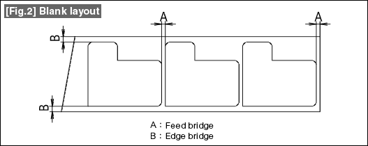

The blank layout is treated in the same manner as blanking as is shown in Fig. 2. However, it is safer to take the bridge width wider than in blanking.
