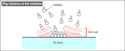

The hydrochloric acid will dissolve rust and scales on steel surface and forms chlorides but will not generate hydrogen (see Dissolution reaction of steel rust, above).  Further into the process, base steel surface is exposed as the rust/scale layer is dissolved and the steel will begin to dissolve (see Dissolution reaction of steel alloy, above), causing hydrogen formation.  Here the steel alloy begins to occlude the hydrogen in atomic state and hydrogen embrittlement will result.
The inhibitor prevents this dissolution of the steel alloy thus preventing the formation of hydrogen.  The inhibitor prevents the hydrogen formation by selectively adhering to the exposed steel surface to prevent the acid solution from contacting the surface, thus preventing the hydrogen from forming.
![[Fig.1]Action of the inhibitor [Fig.1]Action of the inhibitor](http://www.misumi-techcentral.com/tt/en/surface/images/006_1.gif)
As seen above, the use of inhibitors in pickling are effective in hydrogen embrittlement prevention.  However, since chemical composition details are unclear for many commercially available inhibitors, it is advisable to test them before actual use.
