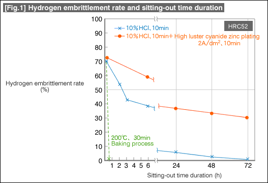

The occluded hydrogen during pickling process is thought to be retained near the steel surface, and is recommended that the hydrogen be released prior to plating layer is deposited. The hydrogen is slowly released by simply letting the part sit out in the air, as shown in [Fig.1] below.

For steel parts that are subjected to long pickling processes, a separate dehydrogenation process (baking) is required. Although it is more effective to bake for long durations at high temperatures, this will cause oxide layers to form on the steel surface, requiring a pickling again. So the baking takes place at i.e. 200 deg.C for 30 minutes, as shown in [Fig.1] above.
For example, baking is typically performed after zinc plating, because this is intended to release the hydrogen occluded during the zinc plating. But, the hydrogen occluded during pickling needs to be released before plating or else the zinc coating will prevent sufficient emission.
