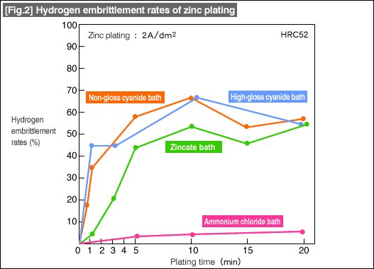

From [Fig.1] above, it can be seen that acidic plating baths such as nickel plating, nickel alloy plating, and chloride zinc plating have very low hydrogen embrittlement rates, but alkaline plating baths such as zinc cyanide bath and copper cyanide bath are more likely to cause hydrogen embrittlement. It is considered, in general, that most of the electrical current applied is used for electrolysis of water resulting in high hydrogen generation with the alkaline baths due to low cathode current efficiency, as opposed to acidic baths where the current is mostly used for redox of metal ions due to high cathode current efficiency.
Hydrogen embrittlement rates of zinc plating in cyanide bath (alkaline) and chloride bath (acidic) are shown in [Fig.2] below.
