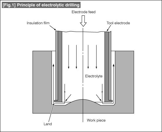

1) Electrolytic drilling
For drilling operations, tubes with various cross sections are used as electrodes.
![[Fig.1] Principle of electrolytic drilling [Fig.1] Principle of electrolytic drilling](http://www.misumi-techcentral.com/tt/en/surface/images/037_1.gif)

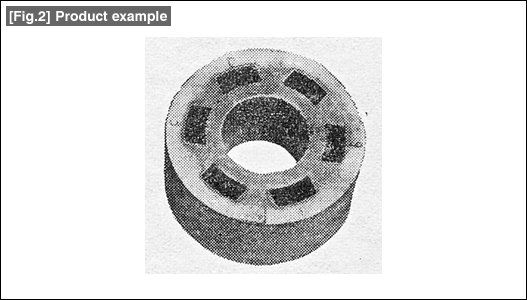

As shown in [Fig.1], the tube's exterior is insulated with epoxy resin or similar, with a somewhat wide land on the end. The insulation on the tube's sides prevent unintended excess over-cutting of the hole ID by any stray current. This countermeasure is not necessary for certain types of electrolytes. It is said that solution such as NaNO3 with small throwing power can minimize the over-cutting to virtually zero. A product example is shown in [Fig.2].

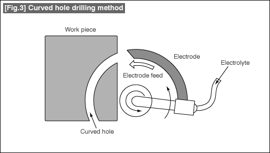

Curved hole drilling
Electrolytic drilling can be utilized to create curved holes or slots easily. This can be accomplished by using a long electrode shaped in an arch, and feeding it in the circumferential direction as shown in [Fig.3].
