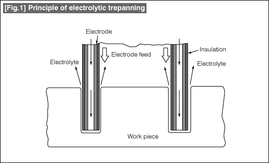

Electrolytic trepanning is a process of cutting out a desired shaped part from a substrate. The process itself is the same as electrolytic drilling but the product is not the hole but the center material of the hole remaining inside the electrode.
The electrolytic trepanning, therefore, uses the same equipment as the drilling process, with a small modification added to the electrode. The electrodes for drilling was insulated on the exterior for stray current prevention, but the electrodes for trepanning is insulated both on the inside as well as the outside. By doing so, a product with a diameter coinciding the cross section of the electrode can be produced. This is shown in [Fig.1].
![[Fig.1] Principle of electrolytic trepanning [Fig.1] Principle of electrolytic trepanning](http://www.misumi-techcentral.com/tt/en/surface/images/038_1.gif)

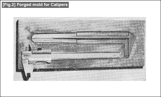

A cavity is a hollow feature. Sinking means "to bore a hole". It can be said that all electrolytic machining processes are variations of this Cavity machining. The notorious example is "EDM die sinking". Die and mold are made of hard cutting material and have complex features, so electrolytic machining is a good candidate and frequently used on forged parts. A notable benefit of this process is that the electrode consumption is low and many molds can be produced with one electrode. An example of a forging mold product is shown in [Fig.2].
![[Fig.2] Forged mold for Calipers [Fig.2] Forged mold for Calipers](http://www.misumi-techcentral.com/tt/en/surface/images/038_2.gif)
