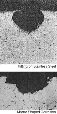

Localized corrosion also causes holes. A small opening diameter but deep corrosion is called "Pitting". For carbon steels, wide opening but shallow "dish or mortar shaped" corrosion occur often. For passive surfaced metals such as stainless steel, pitting occurs. The reason for that is thought to be the following. Passivated metals have several nanometers thick of highly corrosion resistant passive layer on the surface, and normally do not corrode in air and water. But if enough chlorine ions exist in the environment (i.e. sea water) this passive layer can be broken and nonuniform conditions will promote the advancing of the corrosion, thus pitting occurring. |
