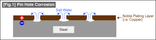

Normally, industrially processed plating has pin holes and scratches occurring from usage, and the metal is exposed at these locations. The behaviors of corrosions occurring would differ whether the plating metal is either more noble than the base metal or not. Nickel, silver, copper and chromium are more noble than steel, and cadmium and zinc are less noble than steel. Aluminum and tin can be either depending on the environments.
With the pin holes on noble metal coat film as shown in [Fig.1], a battery is formed with the base steel being the negative pole, and corrosion will occur.

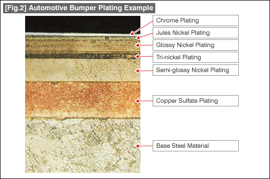

With this type of plating, the pin holes cannot be completely eliminated although the thickest possible film is applied to reduce the porosity. Therefore the usage is limited to ornamental decorating purposes in relatively mild corrosive environments, and not for corrosion protection purposes. Chrome plating is often used as noble metal plating but is not at all effective in environments with water due to the cracks in its film. For office equipment and automotive applications, chrome plating over copper or nickel base plating is often used to improve wear resistance characteristics. An automotive bumper plating example is shown in [Fig.2].
